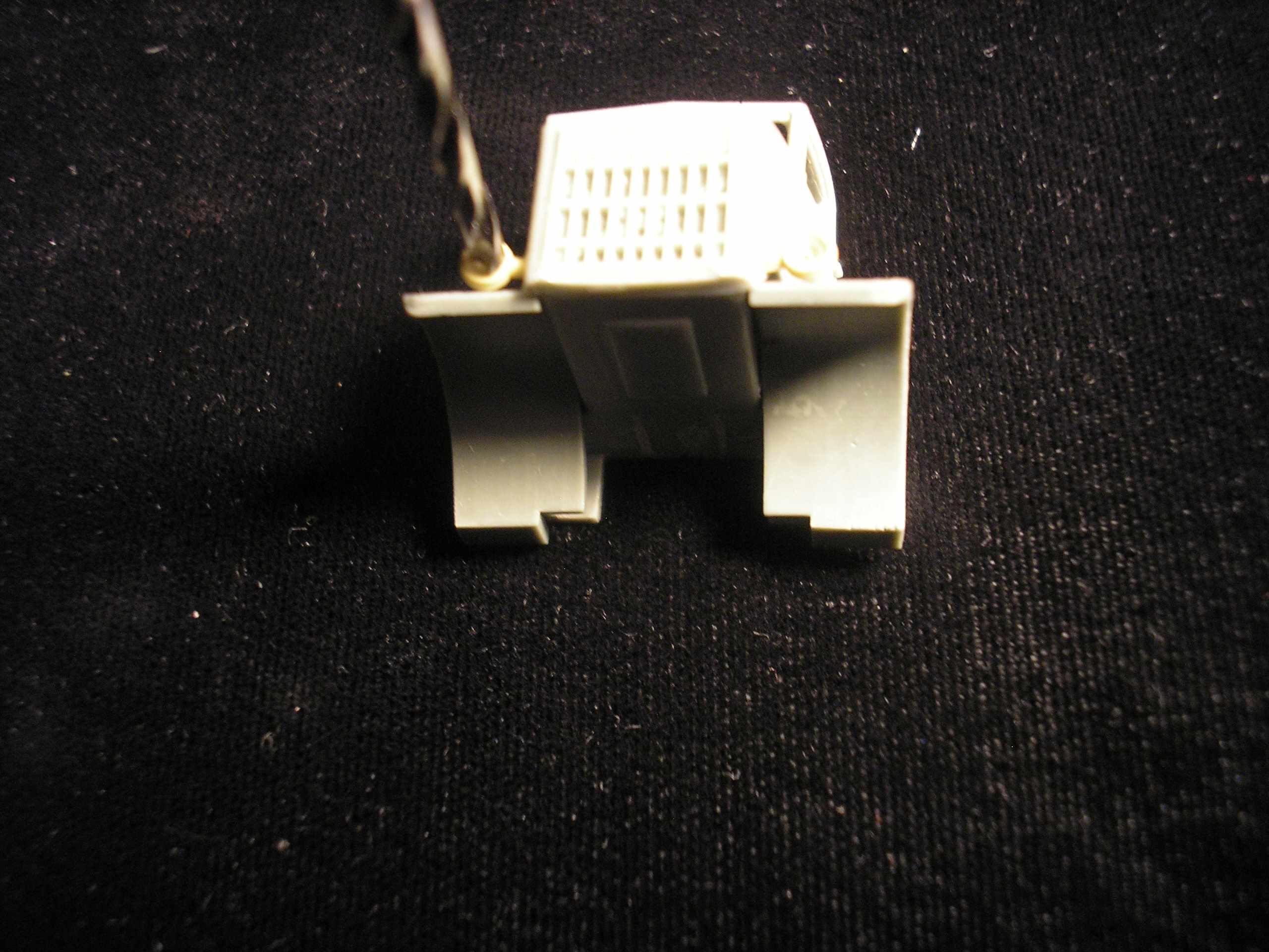

1. measure the diameter of the headlight assemble to determine which size lens and drill bit is required.
2.install the headlights on the model or if the headlights are built in, as on modern vehicles go to the next step.
3.very carefully center the drill point on the headlight and carefully drill with light pressure and NOT too deeply, checking the depth occasionally by placing the lens in the bore to see that it is not excessive in depth.
4. once both headlights are drilled to satisfaction and the model is painted to completion then you can install the lenses with a pin point drop of super glue.
pack of 4 lenses of correct diameter .078"
Headlight and housing to be mounted on model
Headlight with .078" Diameter drill and pin vise.
Headlights mounted and drilling each headlight.
Headlight lens fixed with a pinpoint of super glue
